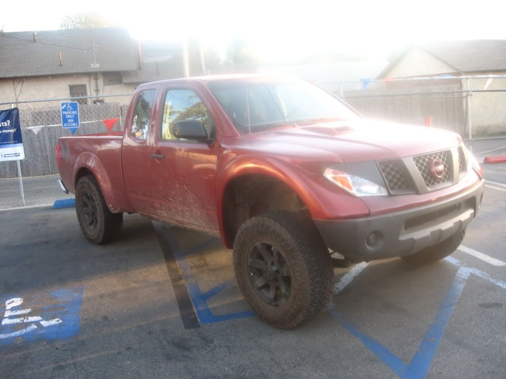

I was 20 when i got my first brand new vehicle...a 2007 nissan frontier xe....i had just gotten a promotion at work at the time and wanted to reward myself for actually doing something positive in my life...for those of you who have met me, you know i'm not a normal person....i live life..extreme....lol...i dont have pics of my truck when i first got it but i'm sure everyones seen a stock xe...lol....i remember the first mod i did was exhaust and a drop in k&n filter...pretty exciting...lol....i had big aspirations for my truck just like everyone else....the day i installed my leveling kit and some 32's was an exciting day.....
one of the earliest pics i have of the truck....later came the titan swap....and then the radflos's....it was very slowly but surely coming together...living on my own, having a gf at the time didnt leave much more room for focusing on the truck but no compaints....and then last summer was when i blew the first motor....(long sigh)...whatever..it got taken care of..lol.....didnt stop me from pushing the truck....
and who can forget the crazy lil mods i did like cutting a hole a in my hood for the ram air intake i had...painting the eyelids on the truck to make it look angry....putting fiberglass fenders because i tore mine up from nose diving and loosing a wheel offroading....

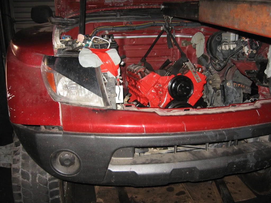

i finally got the point where i was really happy with the hastened pace of my truck...i got the cst spindles, prg shackles, and 35" tires...my truck was finally looking like the creature it is and then.....another motor.....pretty much a year to date from the last motor....i was planning on doing the mid travel kit and hoops finally but what became a stressful situation of trying to find a motor that wasnt in bad shape became a nightmare and i finally buckled down and decided to skip towards the end of my mod list and do a motor swap.....i had dreamed of throwing a v8 in the truck even before i owned it officially....i always strive to be different from everyone else...and i think ive done a damn good job of it thus far....i went for a practical, easy to build, and inexpensive way to start motor swap...thus a brand new 350 block and turbo 400 trans....

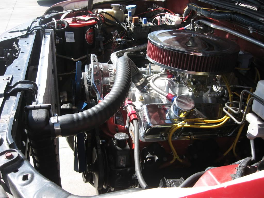

Parts list:
Suspension:
Front:
CST Spindles
Radflo 2.0 CO with 750lbs. spring
extended brake lines
PRG tie rod extensions
Titan upper and lower a-arms
Rear:
Rancho 9000XL's
PRG Shackles
Wheels and tires:
35" BFG Baja TA's
17" Titan offroad wheels painted flat black
1.5" wheel adapter
Exterior mods:
Hanneman front fenders
Custom bedside sticker
Tinted "eye lid design" headlights
Still somewhat functional hood scoop(originally for ram air intake when I had the 4 banger)
Painted front grille and emblem
Painted rear lettering
an assortment of ammusing stickers on the truck
Interior mods:
*B&M Z-gate rachet style shifter in stock location of old shifter
*water temp and oil pressure gauges(mechanical)(white faced)
*Kenwood stereo with pioneer speakers, 500 watt amp, and 12" kicker sub
*On/off switch for fuel, spark, and fan
Performance/Motor Swap:
*GM Performance 350 4 bolt main long block for trucks 1979 to 1986
*stock(new) long style water pump
*GM Performance 100amp 1 wire hook-up chrome alternator
*Performance mini high torque starter
*Edelbrock Performer EPS intake manifold
*Edelbrock Performer 600cfm electric choke carb
*(stock) new harmonic balancer
*stock exhaust manifolds
*Accel performance replacement distributor
*Accel Super HEI coil
*Accel super stock wireset
*Accel U-groove spark plugs
*Optima Red Top battery
*Stock power steering pump with lines retro-fitted to work with Nissan rack&pinion
*Electric external Fuel pump
*pro flow fuel filter
*Spectre HP-R filter and housing
*Melling High volume oil pump
*GM Turbo 400 trans with all brand new internals and B&M Shift kit
*Trans cooler
*Driveshafted modified an 1 inch shorter and with GM trans yoke
*Custom 2 1/4 inch exhaust pipe to a pair of eliminator turbo mufflers
*new radiator

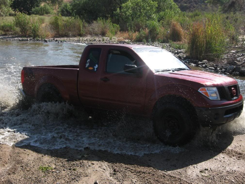

About the pic of the jump, did that casue the fenders to cave? Any other damage to the front end?
aside from stuff being tweaked like bushings and stuff...nope....it handles great

So what does this thing put out for power?
How far off were the mounts for the engine and transmission?
There are no emission componets, right (cats, ecu, etc.)? That would simplify things greatly compared with the other guy doing the Titan motor swap in his Frontier.
