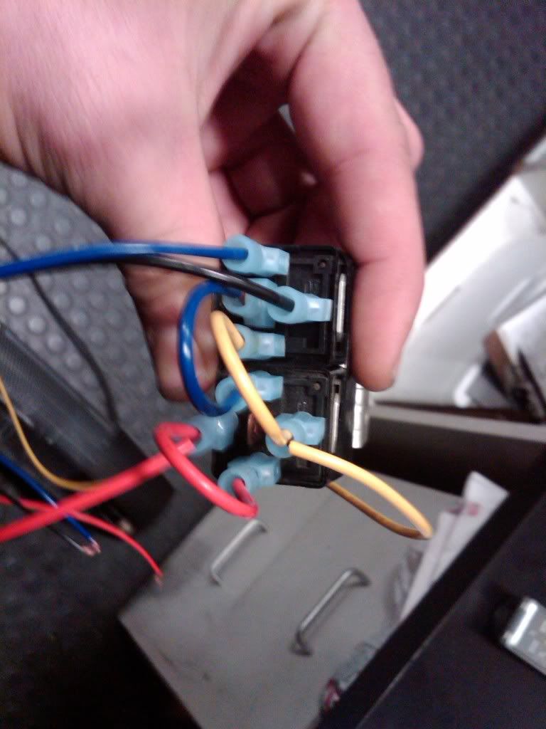

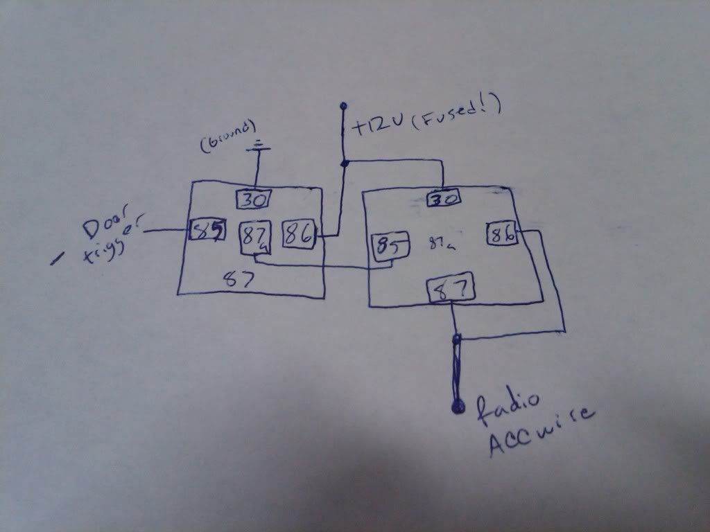

so me and a fellow installer were goofin around with some relays at work today (yup it was slow) and decided we wanted to be cool like GM and have retained accessory power for out stereos, here is a ghetto lookin hand drawn diagram and some photos of it all, if you want to do it and need to know where to locate certain wires or whatnot lemme know i can look it up.
this will keep your radio on untill you open your door:fantastic:

What are the numbers?
those are the numbers on the pins to the relays, they are all numbered so ya know which is which

ya im sure 12volt has em, and there are all kinds of things, i even have a book at work that im sure its in (has all sorts of things you can do, even make an alarm withremote start outta relays) but its also fun to figure it out yourself, and i know this works, vs. finding some random diagram done by whoknows on the web and lettin people on here that may not be familiar with relays see it and try it. This works, its easy and i just thought id share it with the community ;)
