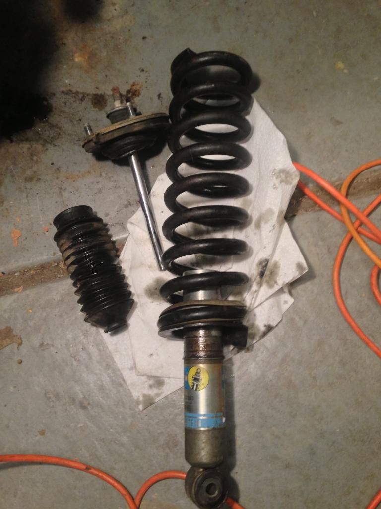

The thing that I like about the TC/Ebay clones is the fact that it has a drop stop bump. Maybe it is cause I am old school. But for some reason I do not trust the shock internal bump stop.
This is from topping out. Sure it was over sprung but...
Haha, thanks. :)
That wheel came off a large rock a little too fast, which I'm thinking topped out/overextended the shock at speed.
