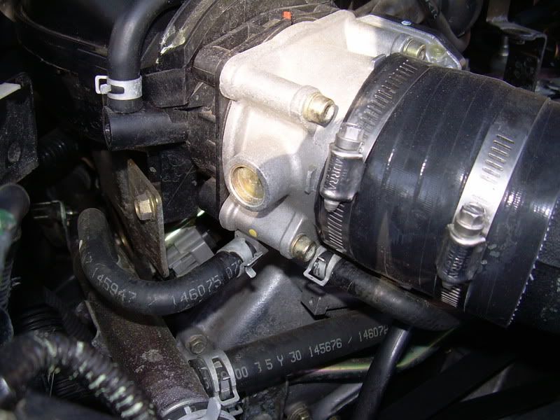

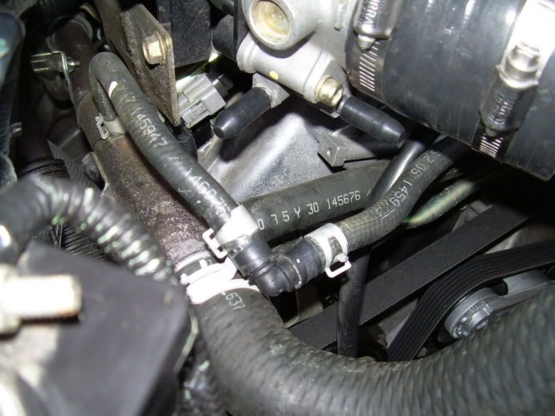

The Pics
You can see the 2 coolent lines in the trottle body
Now with the caps and the L fitting

the TB bypass for the coolant bypass is kinda useless. the system actually has a cutoff valve so when the truck is at opp temp it shuts itself off and stops the flow of coolant. drag racing would be the only place that mid may help. other than that its just gonna cost you more in gas because its taking longer to heat up the truck so your computer keeps you in warm up mode longer so it needs more fuel.
