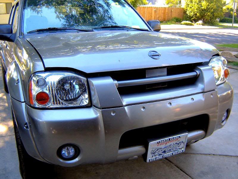

first off, here's a before pic of my truck. yes i know, a lift kit and bigger tires is on the way soon!!!

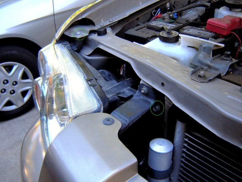

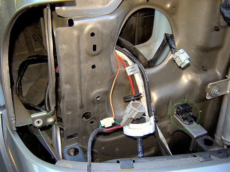

to start off, remove the headlights. i was surprised at how easy it was to remove these lights. just remove the two bolts shown in green here and then the light just pops off. its held by two bolts on top and two clips on the bottom.

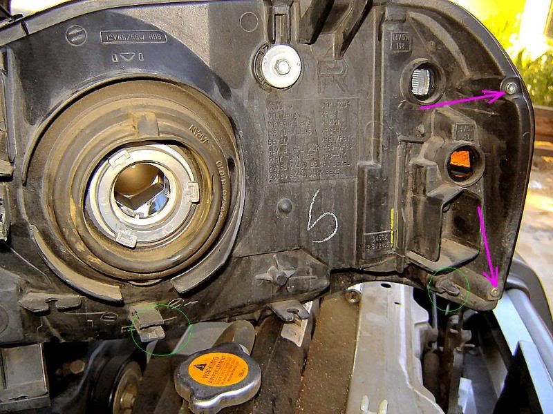

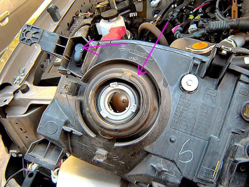

and here are the actual clips that hold the bottom part of the headlight. NOTE!!!! be sure to remove the two screws shown in pink!!!! these are holding the lenses to the body. i found this out when i was trying to pry off the lenses!!

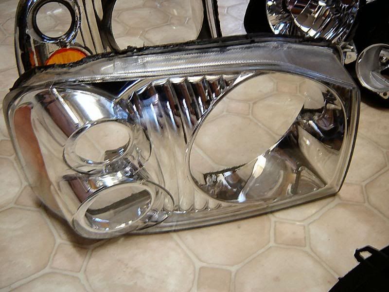

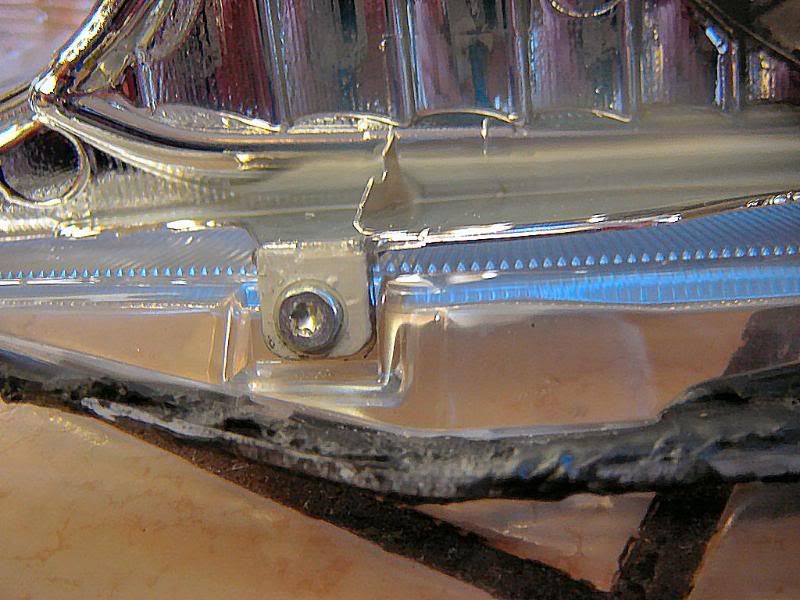

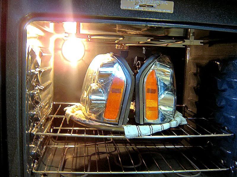

ok heres the fun part! i set the headlights on a pizza pan covered in wet towels. i set my oven to about 220 degrees and left the lights in there for about 15 minutes. the actual amount of time may vary depending on your oven. what your trying to do is heat the headlights up just enough so that the glue/silicone softens and you can pry the lights apart. i dont have pics of the actual prying process since i was by myself, but its pretty straightforward once you get the glue melted.

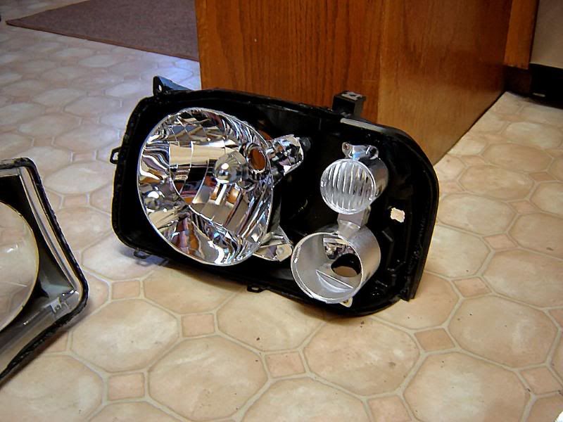

heres the back part of the headlight after the lenses was removed:

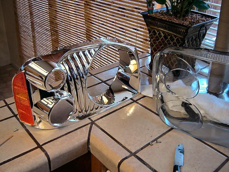

and here's the lenses with the chrome housing still attached:

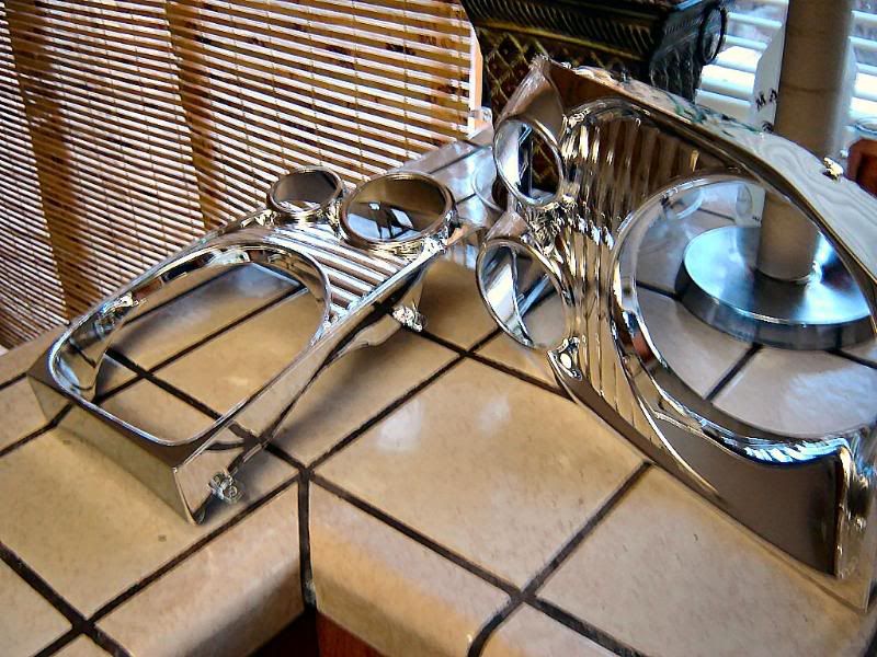

now you gotta remove the chrome housing from the lenses. there are two little screws on the bottom that hold the housing and the lenses together. once you remove these, the chrome housing pops right out.
heres the chrome housing out of the lenses:

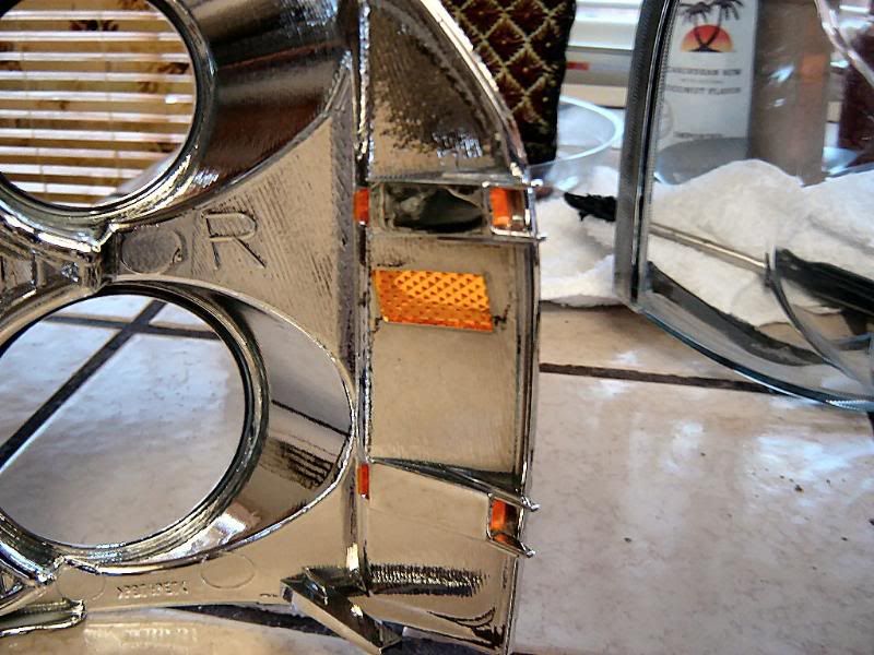

next your going to want to remove the orange corner reflector thats attached to the chrome housing. there are 4 small clips that hold this in place. pop out and remove

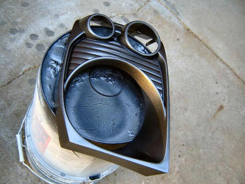

chrome housings removed and ready for prep work
as mentioned above, i decided to use a gunmetal color. i used Dupli-Color's wheel paint in the gunmetal color purchased from a local Kragens for about $6. i have used this paint several times before on wheels and other projects and i love it! the color is awesome and it covers like no other spray paint ive ever used. they have white, silver, bronze, and gunmetal. if going with black, i recommend rustoleum or krylon fusion.
heres the lenses painted and drying. i sanded them down with some 220 grit sandpaper just to scuff the surface. color turned out real nice!

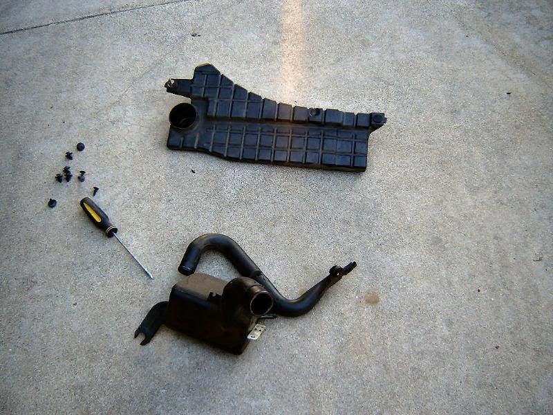

while i was waiting for the paint to dry, i decided to rip out all the airbox silencer junk! might as well take advantage now that i have the extra room to work with.

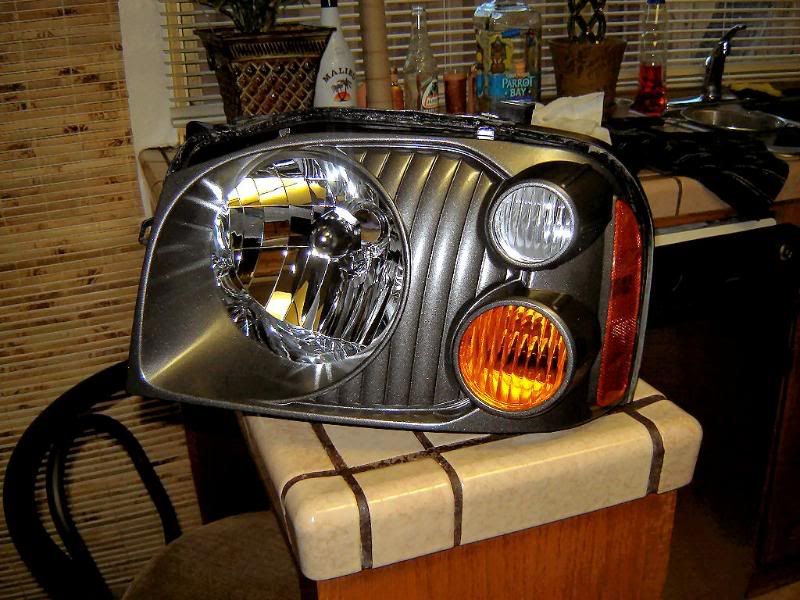

now i dont have pics of the reassembly, but its straightforward as well. after the paint dried, i assembled the lenses and the housing then put them back into the oven to melt the glue and get it tacky.
once the glue melted, i took out the headlights and ran a bead of silicone on the back part of the headlight and attached the two pieces together.

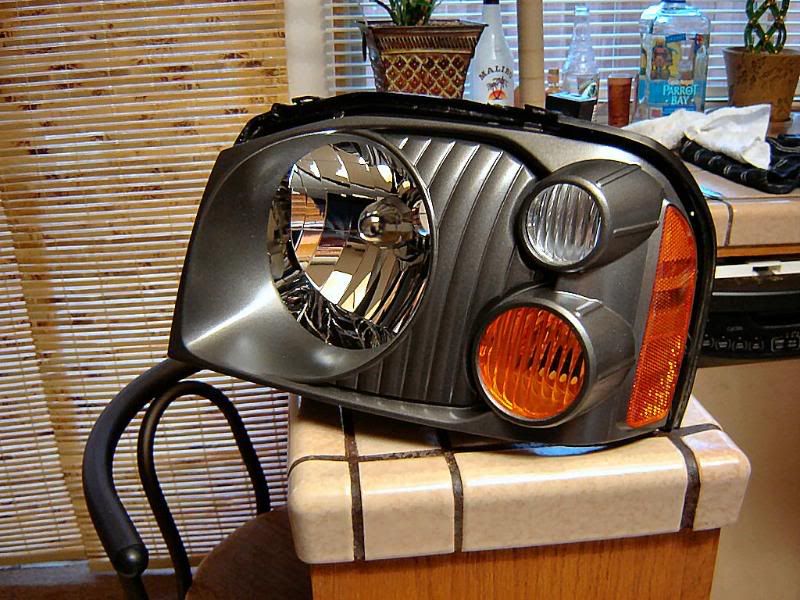

heres a pic of the housing without the lenses. just a trial fit

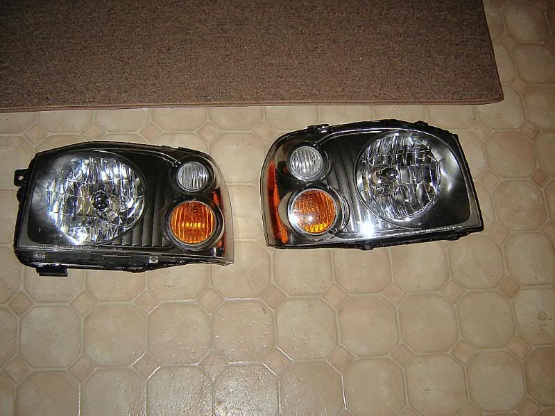

and heres the finished product! the silicone is drying right now, so i dont have any installed pics. i will install the lights tomorrow and take some more pics. stay tuned. i think its gonna look great!

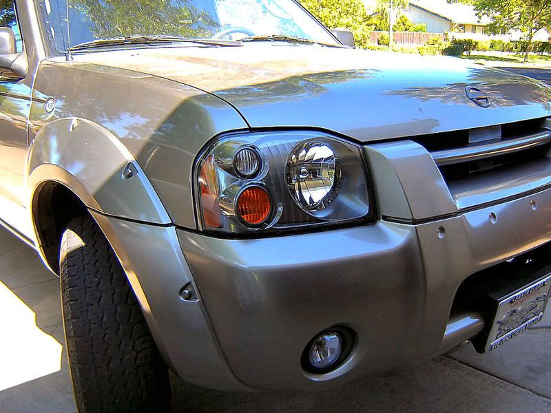

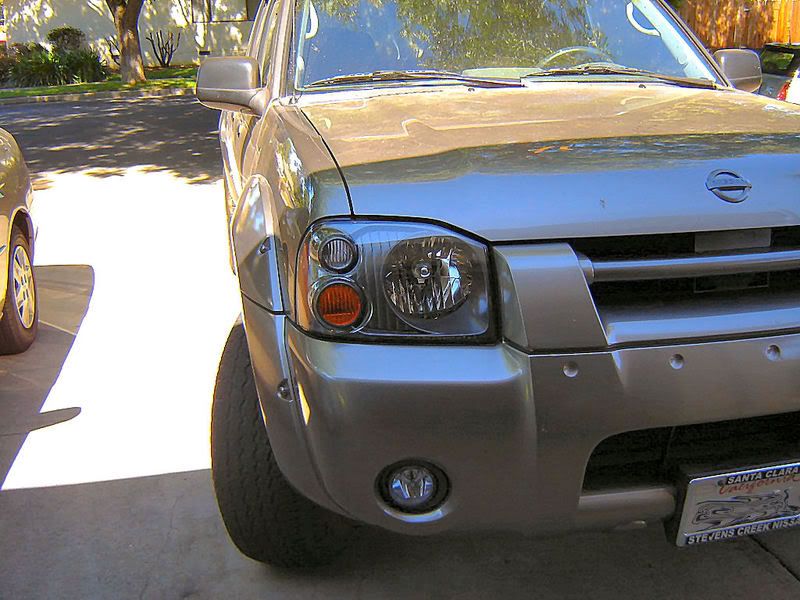

UPDATE!!!!!!!!!Got the lights installed, they look awesome!!! Here's the final pics

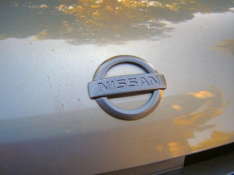

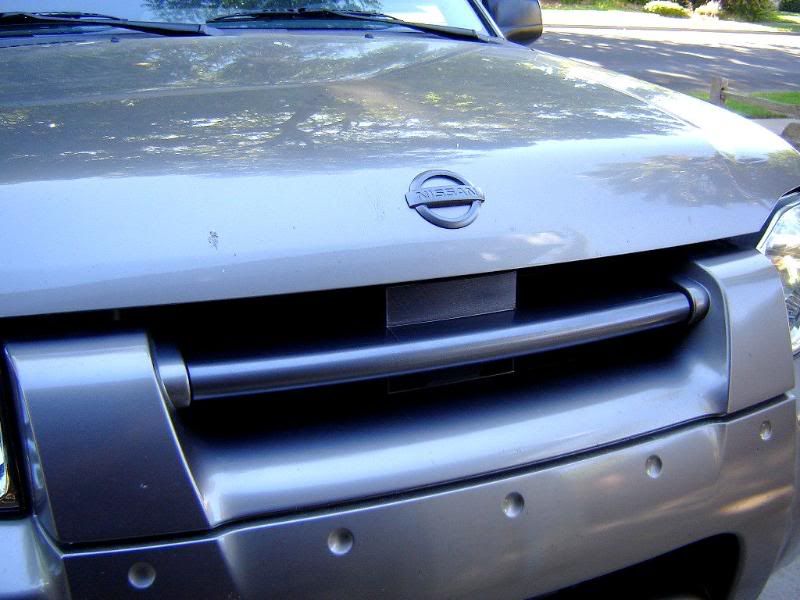

OH almost forgot! i also painted my grill bar and the nissan logo on my hood using the same gunmetal paint so it all matches. enjoy
