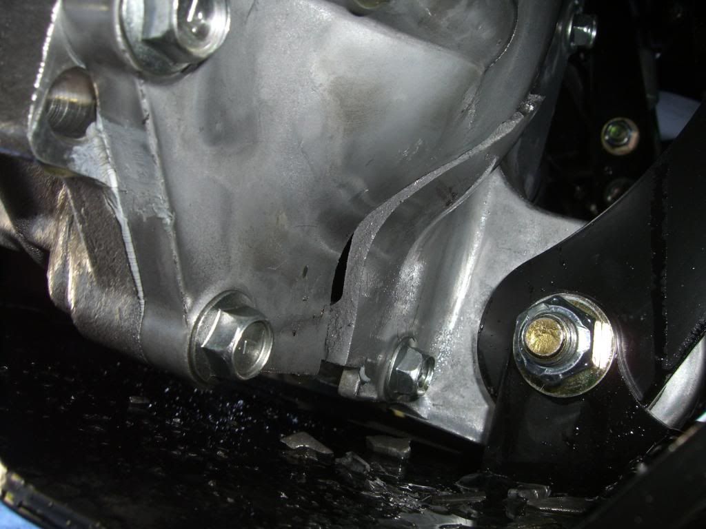

So long story slightly shortened, I had the truck towed back to Fabtech. They had no idea what could have happened cause “That’s never happened before” but they tell me that it was “probably” because the diff oil hadn’t been topped off properly. So 2 weeks later (did I mention that this happened the day before Christmas break?) the diffʼs been replaced and my truck is on its way back to me for the second time with no explanation as to why it exploded while driving in a straight line on the freeway in 2 wheel drive. So you can imagine how super comfy I am now with my new rig considering I have no idea if it’s actually fixed or if I’m just counting time until the next one explodes with my big travel season right in front of me.
All of my trepidations aside, the truck made it through my travel season unscathed and has been on several off road trips with no further issues with the exception of the fact that it still eats the outside edges of the front tires in tight parking lot type maneuvers and refuses to return to center from anything past ¾ lock (think circling jet ski, pretty sure I could step out and watch it circle the parking lot at idle).
Granted, I would never have expected my front diff to take a hike in the middle of the freeway and had hoped that I wouldn’t have to re-engineer half of the ancillary bracket geometry but at least the brass at Fabtech never gave me a hard time about taking care of the repairs and even the towing and rental car charges. I still think that their kit needs some serious R&D upgrades to remedy some of the more blatant flaws in the design, which I’ll cover shortly, but they stand behind their product and the structure itself is nearly bullet proof.

• Possible detonation of front diff for no apparent reason (not a big fan of this one personally, wouldn’t recommend it) – This may have been an isolated case but seems unlikely that I’m the only one this has ever happened to. In any case Fabtech has no idea why it happened. I have had no issues whatsoever with the Calmini kit in this respect. I've put it through hundreds of miles of off road from mild to wild and no vibrations or anything that might lead me to believe my diff is in any more danger than it would have been completely stock.

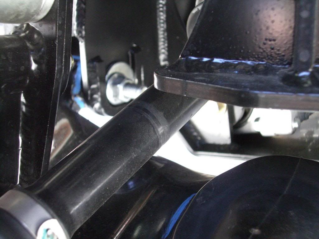

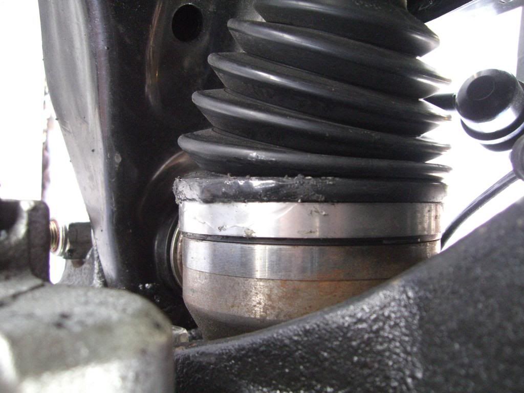

• Extension brackets for the LCA bump stop (Fabtech kit) – Besides the fact that they are too long and limit suspension compression stroke, I also had to grind the front edge of the driver’s side down about 3/8” because it was rubbing on the axle (see pic). As for the Calmini kit, they have issues here as well though not as bad. The front mounting bolt makes contact with the drop spindle body at full outward lock. Other than the fact that it clunks and wears a bit of a groove in the spindle it hasn't been an issue. You could always forgo the self tapping bolt and just tack them on with your welder and it would never be an issue.
How do you not notice that during the install if that’s what you do for a living??

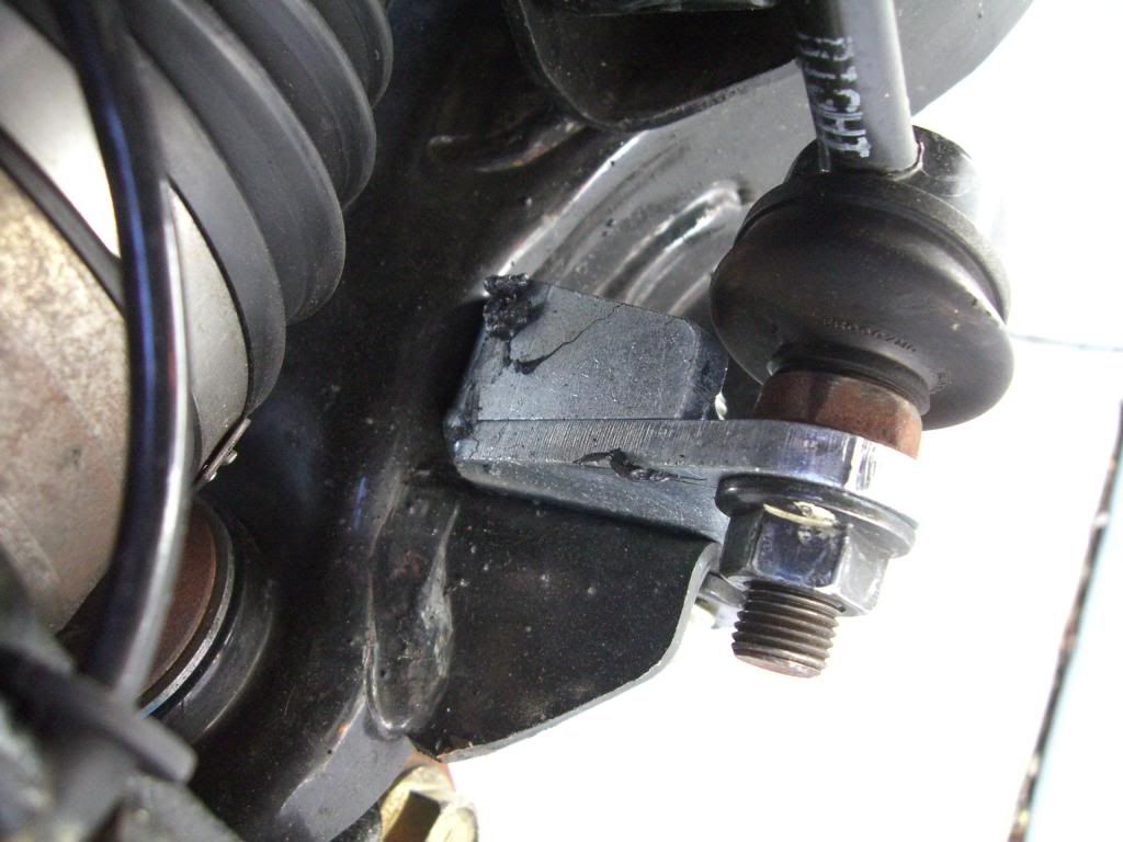

• Sway bar link extension brackets (Fabtech/Not sure on the Calmini) – They mount with a single center bolt so they “rock” when the suspension cycles causing a substantial clunk on turns or when one tire hits a bump/hole that the other tire misses. Calmini uses a better bracket but I never installed it since I added COs from the get go so can't really comment on their function.
Had to reef on it with a 30” breaker bar to get it tight enough to eliminate movement. I will be removing the sway bar once I get the COs so this hasn’t really been a concern (once I figured out what the clunk was anyway). May also be possible to eliminate the extension bracket altogether and get a longer end link, possibly with a disconnect? I’ll research further and edit if/when I find any options.

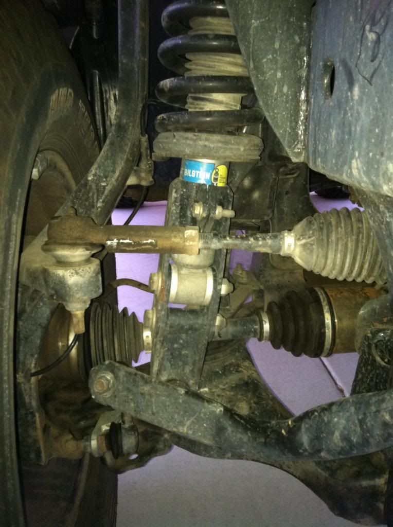

• Steering knuckle (Fabtech/Have had some response from Calmini owners that they have this issue as well) – The steering knuckle on the spindle actually rubs on the strut/CO at full lock. This is more noticeable with bigger COs like the 2.5s but mine also hits the extension bracket on my 5100s so it would also hit the stock set up. I’ve had feedback from owners of both kits with regards to this. Will have to grind on that a bit and experiment with alignment angles when I get the COs. The Calmini knuckle itself does NOT contact the CO. Only the tie rod end makes contact at full lock and only just barely. I hear a slight clunk every once in a while when I'm at full lock and bouncing over a rock but it's barely left a nick in the powder coat of the springs so not really a concern.
• More fun with steering geometry. Not sure why and whether it’s a combination of the spindles and the tire/wheel selection but my truck eats the outer edges off of the front tires during parking lot maneuvers and u-turns. The steering also does not return to center once I get past about ¾ turn to lock in either direction. No issues with this at all with the Calmini kit. Steering feel is great, returns to center just like stock, no abnormal tire wear and it actually took almost a foot OFF of my turning radius!

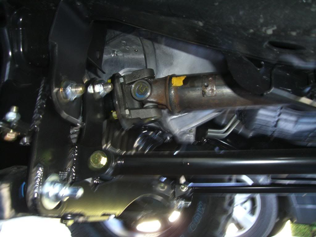

• Front diff drop bracket/front DS angle (Fabtech) – The front drive shaft angles are somewhat less than ideal with the front diff mounting angle on the Fabtech kit. They angle the front of the front diff downward to cut down on axle shaft angles or something but it’s much more than is really necessary. Not only does it eat mass amounts of ground clearance but it also creates a very odd double negative DS angle (neg angle coming off of t-case flange and a neg angle going into front diff pinion. See pic). Ideally you want any u-joint angles to cancel each other out (ie, one angles down at 3*, the other end angles back up at 3*), especially if they rotate at high speeds but maybe their suspension designers were out sick from suspension design class that day? I haven’t noticed any significant vibrations in the front driveline but it still kinda sketches me out when I think about it and whether or not that contributed to the diff catastrophe. Seems like there are thousands of us Nissan owners out there with this design so you’d think the word would be out so to speak if this was happening a lot. In any case, I’m working on a re-design of the diff mounting brackets to alleviate this issue and my concerns with it. It basically amounts to raising the front of the diff back up an inch or two. There is plenty of room for this as the front axle shafts are short of parallel to the LCAs. I realize that this particular section may be a bit confusing if you don’t have this lift or haven’t studied one up close but I have included some pix and can provide more for clarification if needed.
The front diff drop on the Calmini kit is nice and level, just like stock only lower. No funky DS angles and no vibrations at all. I did have to make a slight adjustment to the trans cross member as the front DS balance weight made very slight contact with it. I took the cross member down, heated it up and peened a small recess in the affected area and that's all it took. No further issues with either the DS or the diff.
• Bolts get missed during installation! Even if you had a “professional” install your kit, take the time to re-check as many of the fasteners as you can reach just to make sure. The ham-fisted knucklehead that did mine forgot to tighten both rear shocks, the sway bar end links, the pass side lower strut mount, pinched holes in BOTH front, outer axle boots
and left the rear brake line extension bracket lined up perfectly to smash into my tail pipe when the rear squatted any more than 3 or 4 inches. Save yourself some headaches and possible damages and crawl under the truck and put a wrench on everything. Would also recommend doing it again after a few thousand miles just to make sure nothing worked itself loose.

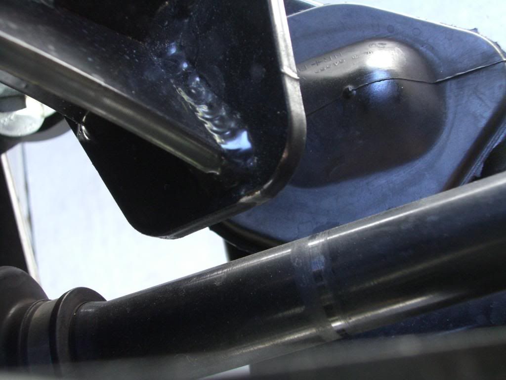

The thing I don't like about the Fabtech kit is the 2 square brackets you see hanging below the db. The Calmini isn't like that.
It's a bit of a pain on occasion but at least they are serious steel and take a pretty good shot without damage. Ask me how I know...
You can see how much lower the Fabtech brackets are than the LCA mounting bolts. That's how much clearance you lose.
The Calmini isn't nearly as bad but it still nets a loss of clearance.
