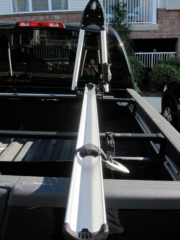

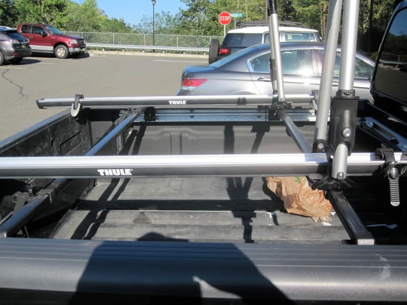

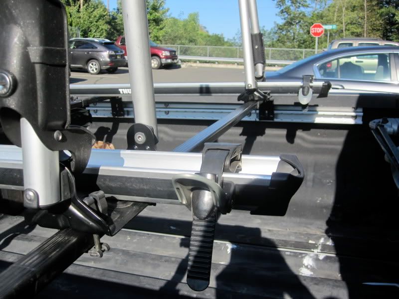

I was looking for a way to make more space in my bed when going on snowboarding trips. So I decided to come up with a rack that i would be able to mount the snowboards to and be able to slide all my gear underneath.
Anyway this is what i came up with.... Note the bike racks are just there for show, im selling them and will be putting snowboard attachments on for winter, and i have the bar pads for my surfboards.
I used thule LB58 load bars, some brackets and wing nuts from Mcmaster. . Any thule attachment will hook up to this.

i think this cost me like 40 bucks tops because i had to buy the 58" Thule loadbars.

we rocked it like this up to VT this past weekend, it was sweet being able to lock up gear in the bed and also kept all our bags and boots from getting soaked in the monsoon on the drive home.

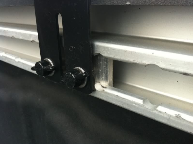

any chance you could take another look on mcmaster to locate these brackets, they don't show up from the link you provided.
click the link then go to the first selection labeled brackets and scroll down a little.
