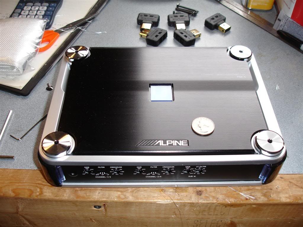

Here's the bad boy powering everything (Alpine PDX-5, 5 channel amp, 75 watts x 4 doors + 300 watts for the sub = 600 watts total RMS):
Here's the carnage involved in installation/hook-up of the amp:

Also how do you like the PDX? I was thinking about giving up my PG Ti600.2 for a PDX 1000 for my sub but i'm alittle skeptical still.
I'm actually very impressed with the PDX-5. For as small of a foot print as this thing (fits right under my driver seat no problem) it pushes some serious power. I couldn't ask for more. It totally jams without breaking a sweat AND stays cool to boot. I give it high marks thus far.
Nice job! You are going to love that amplifier, I just built my friends system in his Tacoma and he used those amps. Those are my next upgrade:goodjob:
