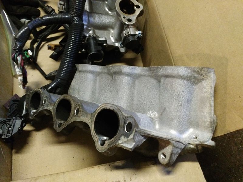

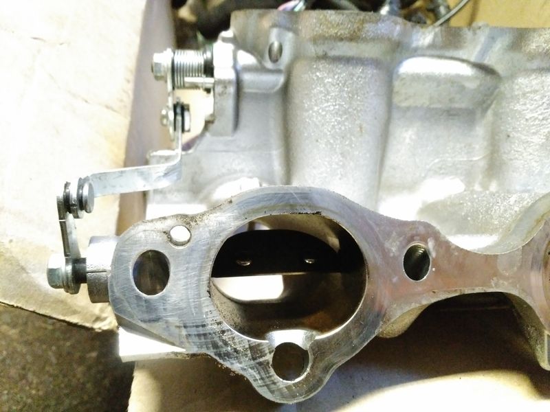

The only difference I've found so far is the lower intake manifold. The newer one has butterflies in the runners. I didn't get the ecu with the engine, so I'll be swapping my old style manifold onto the new engine.
Old style lower intake manifold
New style lower intake manifold
4
Got the new engine in and running, so swapping a newer style VQ40 into an older D40 chassis is possible with minimal changes.
Besides the lower intake manifold, the only things I had to change were a bracket for the wiring harness (newer style engine has the bracket on the water pipe, older style has the bracket bolted to the engine) and replace the oil pan sensor (newer style uses two sensors, older style uses one. Screw an old style in and leave the 2nd sensor unplugged).
