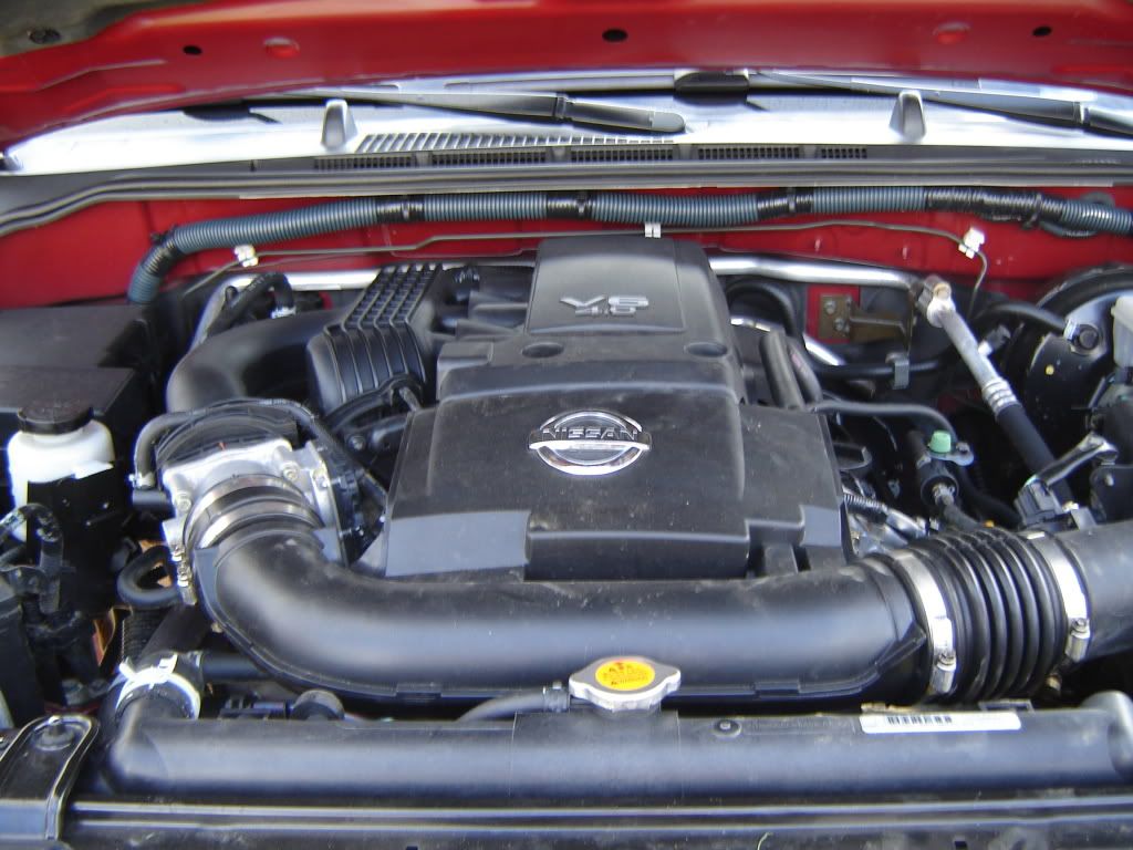

Remove the 2 bolts holding down the engine cover and pop it up and out of the way. Loosen the clamps on both ends of your intake tube. Remove the 2 bolts holding it down and maneuver the intake tube out of the way.

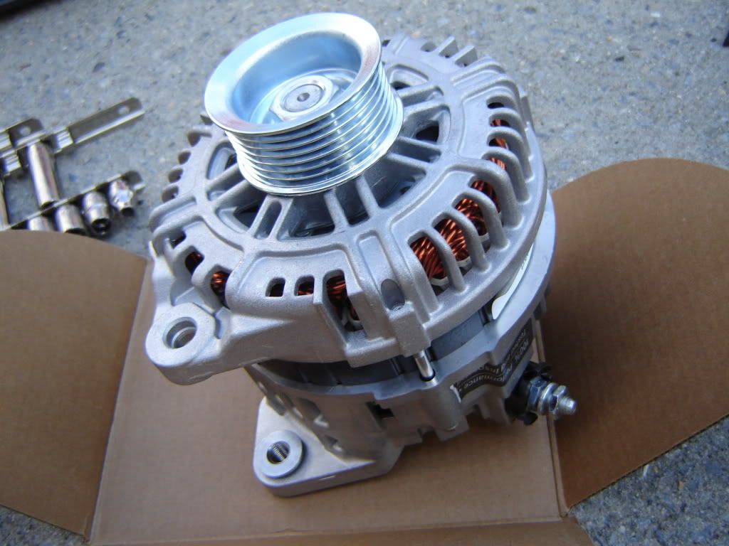

As compared to this shiny new (rebuilt) one:
Here's what your engine compartment should look like at this point. Nice and empty.
Install is reverse of removal. Remove the zip-tie clips from the back of the old alternator and reinstall them on the new one. Finagle it back into the engine bay and line up the bolt holes for the long upper bolt. Connect the lower bolt through the bracket. Connect the ground and main power harness to the alternator. Torque down the bolts to factory specs.
Check out this awesomely quiet, clean alternator:
