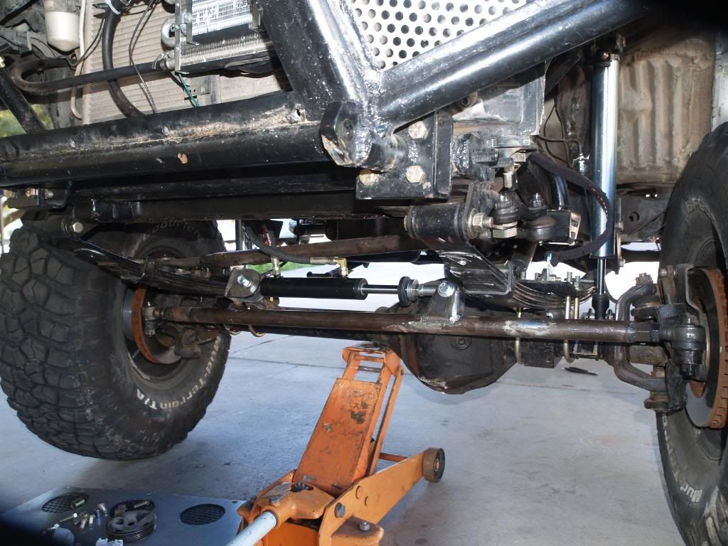

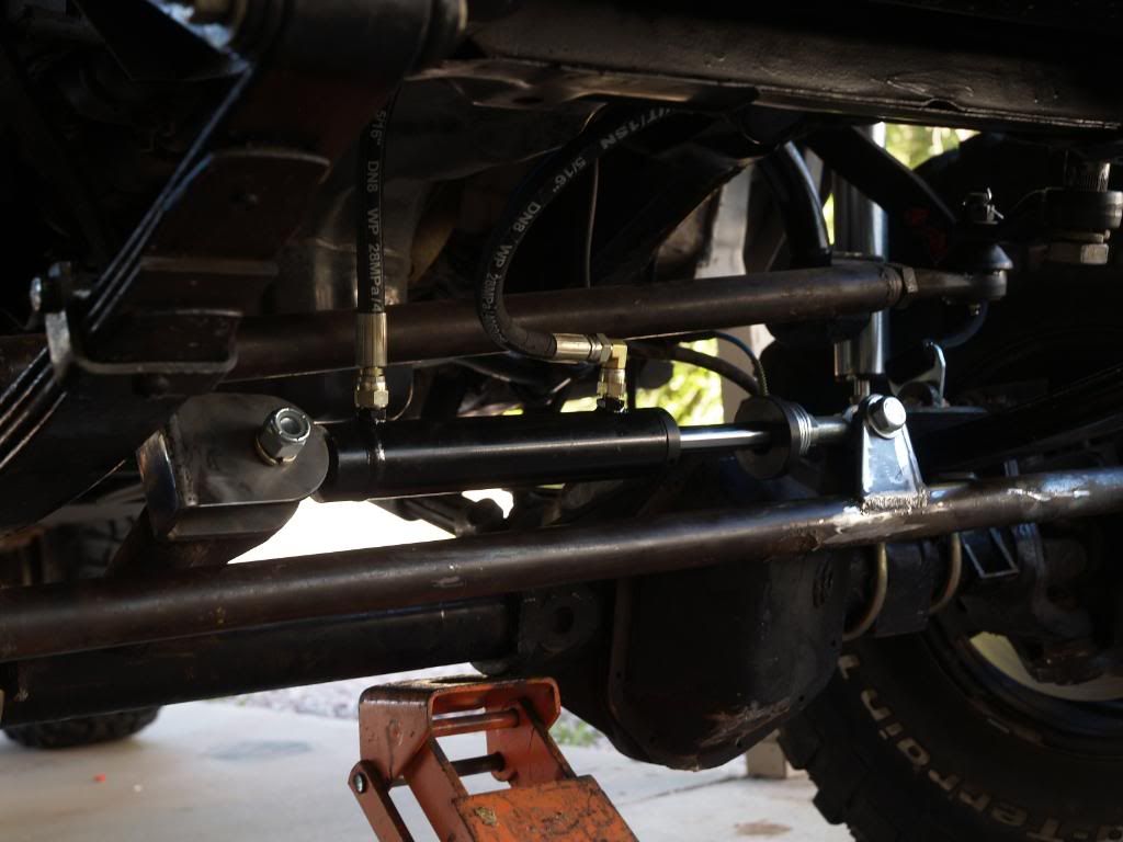

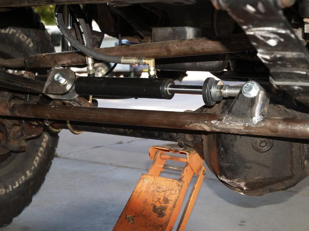

decided to go ahead and put hydro assist on the truck because some times when out wheeling the steering wheel is a workout to turn
i need to go to lowes and find another piece of strap to hold up the PS cooler , the one piece was what i had laying around lol
those zip tie things that come with the cooler are a joke
drilled and tapped the box

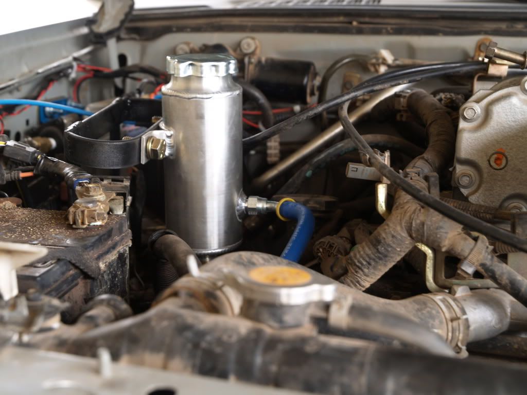

i ended up moving the resevoir right over the pump because i didnt want to buy a 45* or 90 * and cut down on the flow goin to the pump

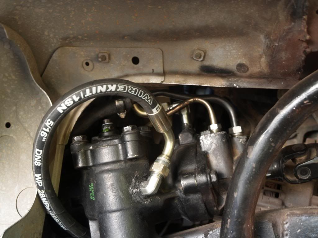

this hose i was able to spin so its tucked behind the fender
one of the best mods ive done since the SAS , make the wheeling much more enjoyable :)

with the waggy 44 the nissan box is just enough to where the stops on the knuckles dont hit the c's , which works out perfect

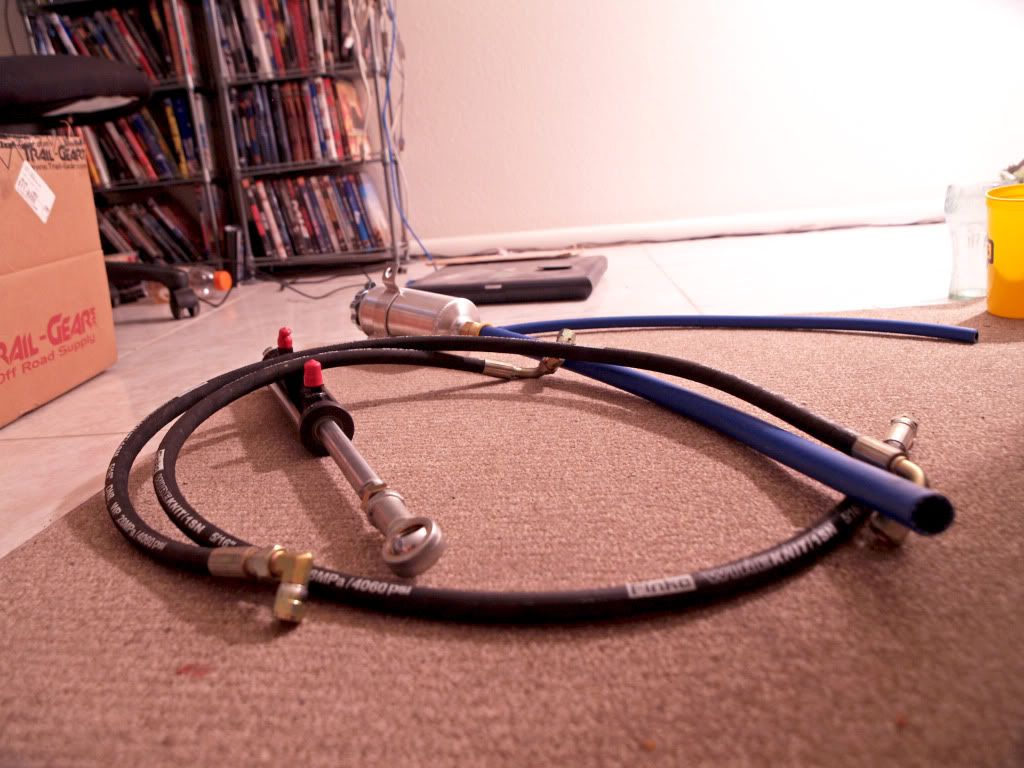

i just went with the trail gear ram with hoses and brackets , and new resevoir because i got a really good deal on it
the steering box i got from napa about 3 months ago so everything was new on it
the pump i got built to hi-flow from a local shop here in az
i did look at PSC although the route above was much cheaper
