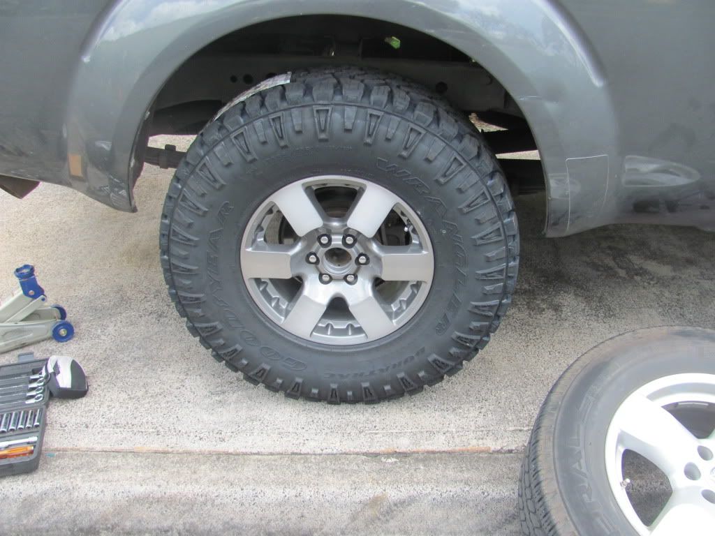

Suspension & Tires
Setup:
285/75/16 Goodyear Wrangler Duratracs
Pro-4x Wheels
Radflo 2.0 Coilovers (3" Front)
2" PRG AAL (2" Rear) & 5125 bils in the rear.
Special thanks to x_mods for helping me install the lift. Front and rear took us about 7 hours.
So far I have not done any mods (pinchweld, heat gun, etc) to make the tires fit. I have had no rubbing issues so far. Still waiting to see if I get rubbing with the suspension loaded while turning.
So I spent hours trying to figure out what wheels and tires would fit. As we all know not much selection for rims and to be honest there were only a handfull of rims that I liked more that the Pro-4x's. I ended up buying a pair of Pro-4x wheels off a CF member and had them shipped to Hawaii. I didn't want to bother with spacers/adapters and didn't want to worry about "recon" permits with the wheels sticking to far out etc.
I spent many more hours learning about lifts and decided to save for components that would improve the ride while also providing a lift. This setup cost more but I am happy with the results. Truck had 50K on it so I figured it was time to replace some of the stock stuff anyway. I figured that 3" was about the threshold for the front before having to spend big bucks (UCA's and Spindles) and I wanted to see if I would be happy with a 3" lift. So far so good. I like the look of the 3" lift. It feels like a truck now. As others have commented, this is how it should have been from the factory.
Here are some pics. I will post better pics later when I get my better camera.

Pics of lift with stock LE tires
Radflo 2.0s powdercoated black
Installing the new bils
I will post better pics of the truck with more/different angles after I wash her :)

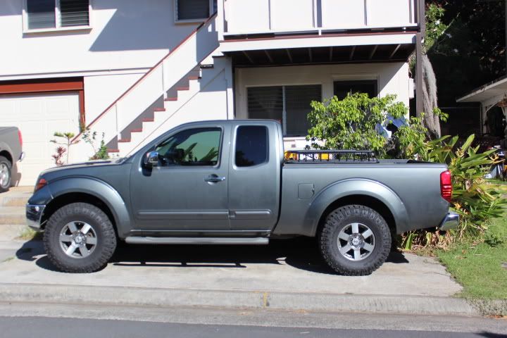

Utilitrac Mounted Bed Basket
Exterior Mod Update:
So I wanted to play around with the look of the truck and see about mounting a basket in the bed. This is version 1.0. Mostly an aesthetic mod (trying to change the look of the truck) but also wanted the added functionality. Needed the basket to be removable for when I go mountain biking.

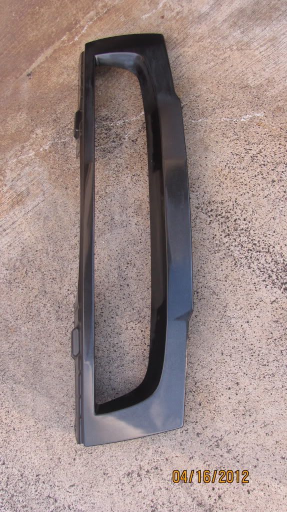

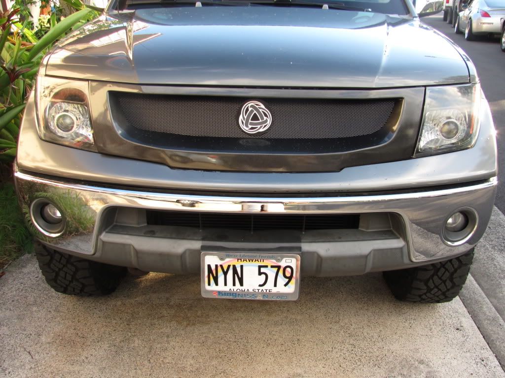

New Grill
3 months later....Finally finished my grill mod. Grill was purchased from x_mods who bought it off of ebay. Mesh was bought from metrorestyling.com. I will have to look at my receipt to see which specific one I bought but I really like how it is not that visible/transparent. I made the burger. Grill was painted with color match paint from automotive touchup.com.
I am happy that this stuff is not sitting in my garage anymore! I like the grill with the custom burger but will have to wait a while to see if I keep it or not. I like the stock grill with the Nissan "v". Gonna run this one until I can paint/colormatch the stock one and install some kind of custom mesh and then decide which one I like better.
Closeup showing the mesh.
The mesh that came with the grill (top) vs. Mesh from Metrorestyling.com (bottom).
