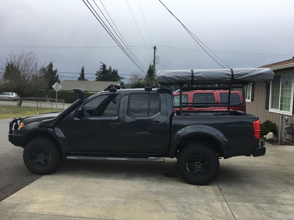

1 Posts
Graveyard thread revival... but I run 235/85r16 and LOVE them, I have the Goodyear Wrangler Duratrac's and my truck can climb things I never would have dreamed it can do, absolutely love the size and don't think I will ever change it! Tall and skinny cuts through snow and mud awesome in BC Canada here on the trails I go on.
