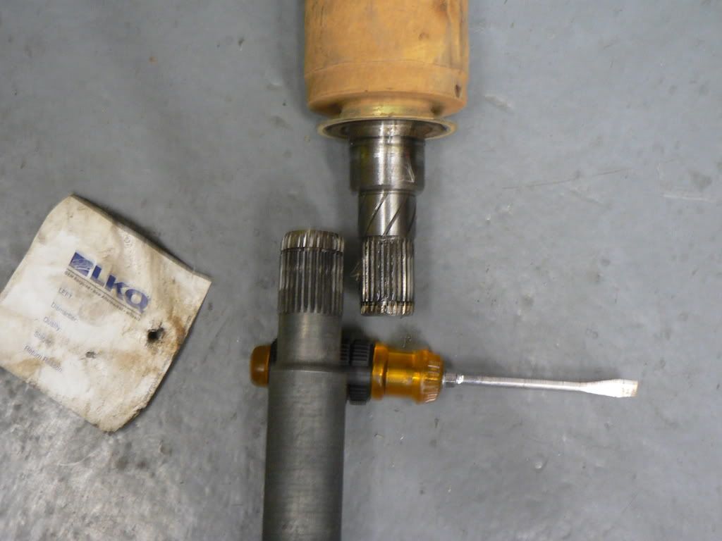

Over here it is rare and when it does happen it's the half shaft is the cause.
When you brake a half shaft you know it right away. First the pop is a lot louder, you can grab the inner joint and move it up and down, also you loose 4WD.
Here is what the half shaft pop sound like.
YouTube - broken front diff
Here is what brakes.
This is the broken off axle in the diff.
If the axles brakes off inside then you need to remove both half shafts immediately to save the diff.

I'm still wondering how many of the blown front difs had the sway bar. As tight as the sway bars are on these rigs, I don't think the front stands a chance. Also those spiders look soft, not a good raged break like most hardened metal.
Also the titan front is just a 2 spider set up.
