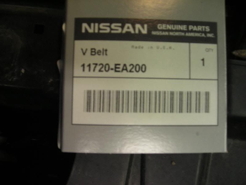

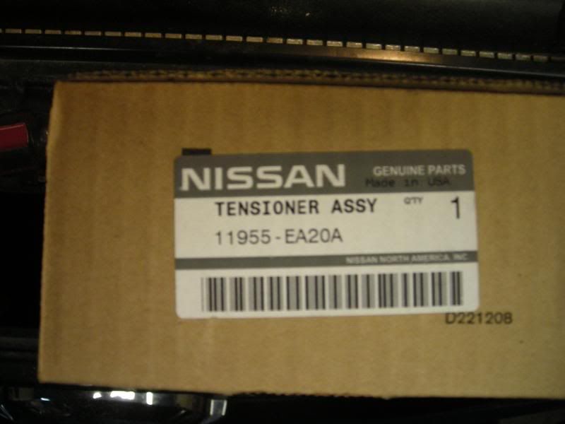

Parts needed

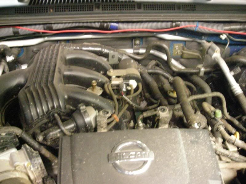

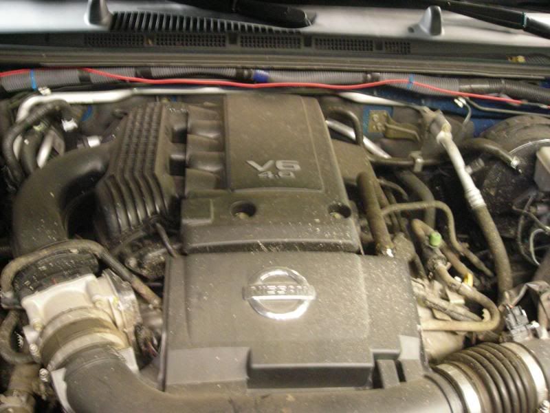

Start by removing the engine cover, 2 10mm bolts then pull straight up.
Then remove the center portion of the intake. 2 hose clamps and 2 10mm bolts.

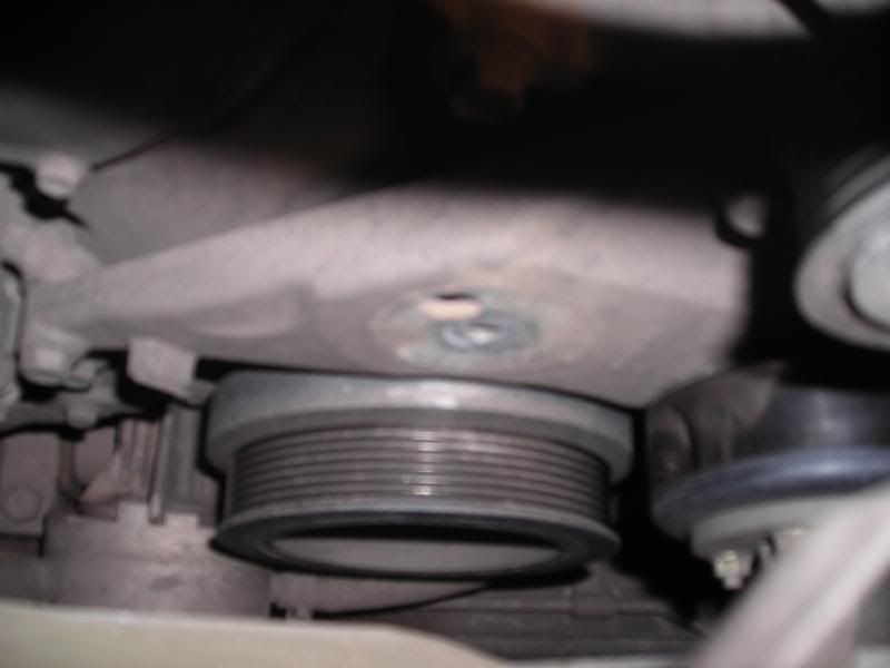

Here is the tensioner.

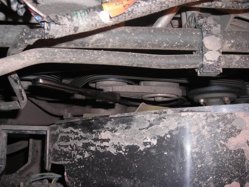

Next remove the belt using a 3/8 ratchet to take the tension off of the tensioner.
Next remove the 14mm bolt holding the tensioner to the engine. Your only option is a wrench as you can't get a ratchet in there with the fan. This is what it looks like once you get it out.
