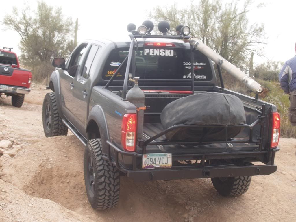

Penski/sexy6chick 07 se
Username: Penski/sexy6chick
Year:07
Make:nissan
Model:frontier
Trim: 4x4 se
Color: storm grey
Mods:
Interior:
cobra cb
Exterior:
custom front bumper and skid
custom rear bumper / tire carrier and light bar/shock hoop (driveshaft is no longer there lol )
custom sliders
bedlined rockers
Drivetrain:
m226 axle with 3.69 from a manual kc nismo 4x4
front diff with 3.69
blue torch fab diff cover
extended axle shaft from PRG products for front driveshaft
Suspension & Tires:
2.5 SAW's with 500lb coils
PRG titan upper control arms
stock titan lower control arms
PRG rear leaf pack with calmini 1.5" shackles
1525 14" travel rear shocks
Armor:
removed
Performance:
transmission cooler
trans cooler pics
Gear and Other:
recovery tools
In Progress:
pro comp 7089 16x8's with 285/75/16 BFG all terrains
with just a spacer lift
after 2" bl
as of now minus un-painted bumper
titan suspension swap Saw's with 500lb eibach coil overs, 14" travel bilsteins , prg 10 leaf pack , shrocks skids and just about everything else i made
02 sc cc 4x4 SAS'D

update:
pro-comp 7089 16x8's came in today , thanks to steeevo at ruggedrocksoffroad
will get pictures tomorrow of the 285/75/16 bfg all terrain mounted on them

update 11/21/09
got the pro comp rims from steeevo over at 4x4 Parts, Nissan 4x4 Off-Road Parts and Accessories | Rugged Rocks Off Road and Communications
and picked up some 285/75/16 bfg 's from craigslist
next tire size will be 35's but the 33's were too good of a deal to pass up for now as we were in need of tires
