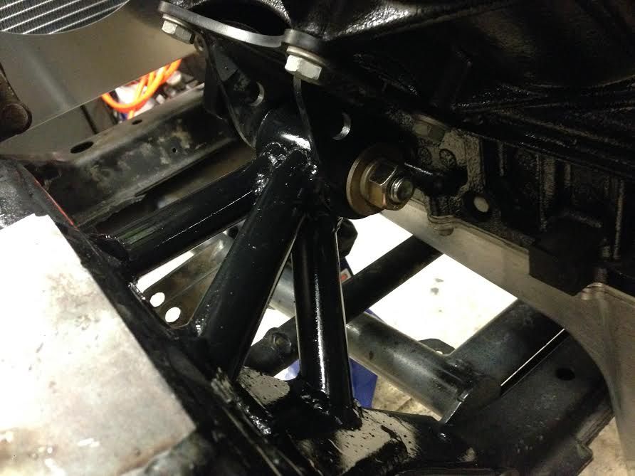

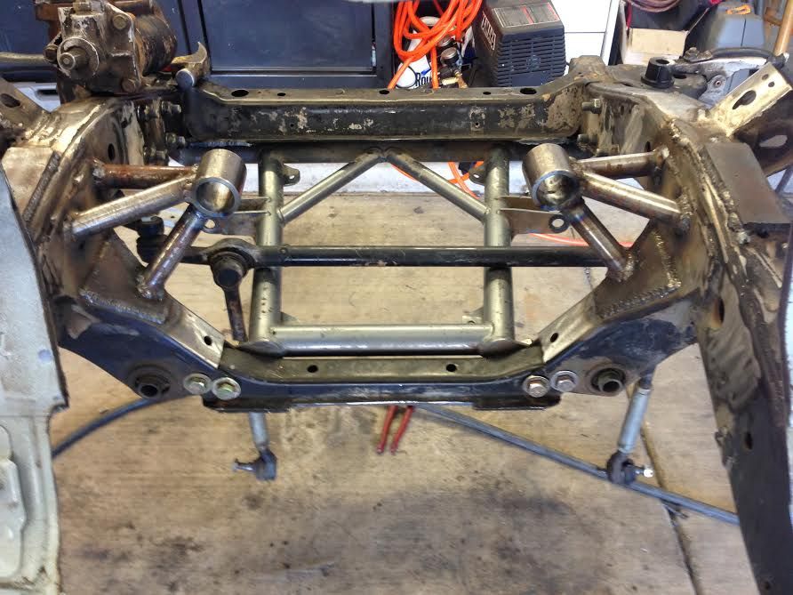

After Lots of practice, Here are the engine mounts I made. I bought them as just flat pieces of plate and welded them how I wanted them.

Added some more strength to the cross member where I was going to mount the engine

Motor mount design I came up with. Pretty sweet looking.
Engine is IN!!!!
